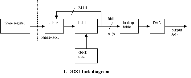

The main components of a DDS or numerical oscillator, NCO, are:
- the phase register
- the phase accumulator
- A clock oscillator
- lookup table
- DAC
The phase register holds the value of the phase increments. Every clock cycle this value is added to the preceding one. The result is latched and fed back to the binary adder.
The greater the value in the phase register, the faster the DDS steps through the signal phase, the higher the frequency. A complete phase cycle is finished, when the phase acc. rolls over.
To generate the output signal A(t), the linear phase information j(t) has to be converted to a harmonic signal. The lookup table holds the corresponding amplitude info. To generate A(t), the DAC is fed with the output of the lookup-table. The binary phase info is truncated to 8 bits in our example.
The table can hold sine info or other waveforms.
If the output of the phase acc. is fed directly to the DAC, a saw-tooth waveform with high harmonic contents would be the result.
The output frequency can be calculated with the:
DDS tuning equation:
(equ. 1)
Where M is the value in the phase register (frequency set), n is the bit length of phase accumulator.
The frequency resolution of the DDS is:
(equ. 2)
It depends only upon the bit-length of the phase acc. and the clock frequency.

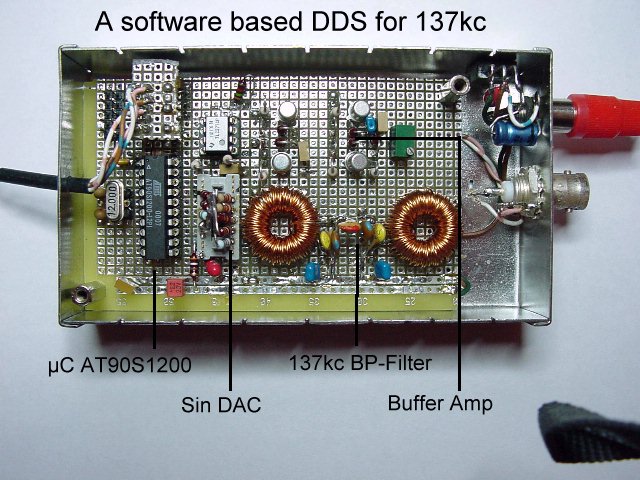

- µController
The AT90S1200 belongs to a new generation of low cost high speed RISC controllers manufactured by ATMEL.
These controllers can perform a single instruction within 80nsec (12Mc crystal).
They contain 32 internal registers, RAM and EEPROM and are in-circuit programmable via a JTAG connection. Programming SW can be downloaded from the ATMEL homepage.
A STK200 starter kit is available for programming the AT90xxxx controlers; Price in DL is abt 75,-eu.
- Software DDS
The AT90S1200 generates the samples of the desired output signal. The software main loop increments the 24 bit phase accumulator, transforms the (linear) phase information j(t) to a binary output word BW(t) via a look up table.
The complete software-loop needs 10 instructions, so the sampling frequency fclock is 1.2Mc. About 8.7 samples of the desired output frequency fout are generated.
The BW (t) is output via port PB0 .PB7 to a Sin- DAC, which converts the binary data directly to a Sin-output current. The following current to voltage converter , IC U1a, delivers the final harmonic signal u(t) to a band-pass filter.
A buffer amplifier completes the circuit with a low impedance voltage source. The output voltage can be adjusted to 1V RMS.
Tuning is performed simply: Three pushbuttons are used to increase or decrease the output frequency. -The middle button allows smaller f-steps. All buttons are ored to the interrupt input, because the software main loop cannot poll the buttons. If the buttons are down, an auto increment funktion is activated. The interrupts of the auto increment are audible.
Pushing both outer buttons simultaneously will reset the frequency to a default value of abt137kc. Referring to equ.2, a theor. frequency resolution of about 0.07cy is possible, but not realized. The coarse tuning increments in abt. 20cy steps, fine tuning is done in 5 cy steps. Both can be changed by software, if necessary.
It should be mentioned, that the absolute accuracy is of minor importance; The quartz used, is a cheap µC-type, with about 10-5 precision. For higher accuracy, an external Qu-oscillator should be used.

The circuit is completely assembled on a lab-PCB. (see picture). The PCB size is 10cm x 6cm. It fits into a small shielded box. The 5V regulator is mounted on a side wall. Total current consumption is 30mA.
High Q 1mh toroids, or ferrite coils should be used for the design of the bandpass recovery filter.
The ATMEL AT90S1200-µController is a DIP 20 type; The 12Mc- high speed version must be used!
The OP-amp used for the I/U converter is a cheap dual FET-type TLC 272 (DIP8); Unity gain bandwith is abt 2Mc. It works with a single 5V supply.
The complementary transistors are small signal types; Others, like the BC547/BC557, can be used as well.
This project is not for beginners on LF. Expirience in rf- and test gear is required.
