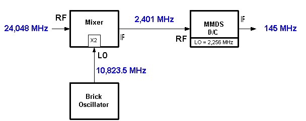

Concerns about strong LO products and image frequency proximity led me to follow a path I thought might be "safer" for a neophyte. I chose to use the now-comfortable 2,401 MHz as the first IF, allowing me to more easily filter out one side of the LO products and consequently placing the image frequency almost 5 GHz away from the desired frequency. A second benefit of this scheme is being able to use a filter wide enough to pass both the satellite band at 24,048 MHz and the terrestrial band at 24,192 MHz. A third, and significant benefit this scheme offers is using the 2,401 MHz first IF to hear the AO-40 S-band beacon in order to accurately point the antenna. This last benefit may prove to be the most noteworthy, as both N1JEZ and G6LVB tell me how very difficult it is to find the K-band signal in three-dimensional space.
Taking The Low Road

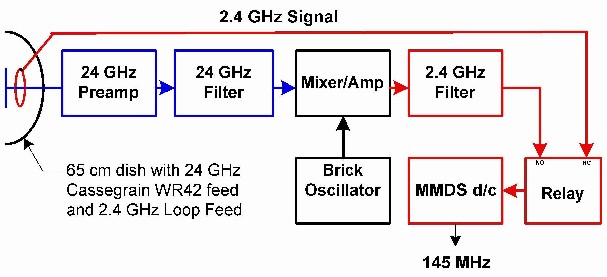

Starting with the received radio frequency (RF) of 24,048 MHz and an IF of 2,401 MHz, a simple
mixer requires 21,647 MHz. The heart of the design is the mixer, a surplus P-com downconverter
obtained from WB5TBL and documented by W5LUA (4). This particular downconverter has a
built-in LO doubler circuit, ahead of the mixer, so an actual output of 10,823.500 MHz is required
from the brick oscillator. The basic receiver frequency scheme is shown in Figure 2.
Many of the design schemes popular for 10 GHz use high side injection of the LO. Using low-side injection, i.e., the LO frequency is below the desired RF frequency, allowed me to keep the LO below 11 GHz and also avoids the confusion of an IF tuning in the reverse direction from the RF. As it turns out, finding surplus brick oscillators in the 13 GHz range required for high-side injection is considerably more difficult than finding 10 GHz oscillators.

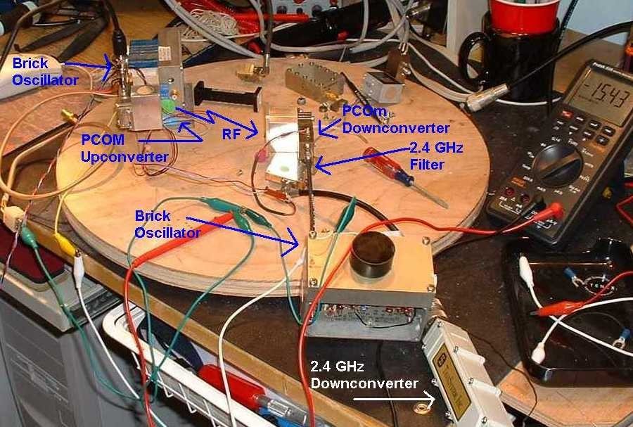

First Laboratory Trials
The first order of business is setting the LO frequency. With the help of AG5RS and his well-
equipped RF "laboratory," we set the surplus brick oscillator at 10,823.500 MHz. Then we
arranged a P-com upconverter and downconverter pair to face each other across a 6" (150 mm) air
gap and injected a test signal into the upconverter's IF port. We were stunned when we
immediately heard the signal in the 145 MHz IF receiver (my trusty FT-100). AG5RS used his
hand to block the 6" air gap to verify we were actually hearing the K-band signal and not an IF
image or noise (both up and downconverters used 2401 MHz as an IF). Figure 3 shows the crude,
but ultimately effective, test setup.

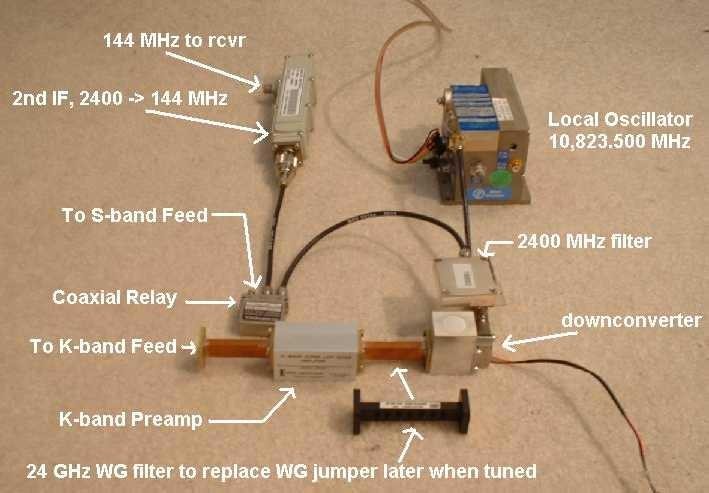

I waited until this first critical test was completed before taking the next steps: buying a DB6NT preamp and designing and building a portable "rover" type setup. The new preamp was a bigger investment than the total of everything I had spent so far, but it was a critical component to achieve the needed NF and gain. For the adventurous, W5LUA has an inexpensive home-brew design you may want to tackle (5). Following the successful laboratory trials, the receiver design matured to the one shown schematically in Figure 4 and in mock assembly in Figure 5.

waveguide assembly. Then I found a surplus 2' Andrew 23 GHz prime focus dish on
ebay—a change in the plan. I had also recently seen K5VH's 2.3/10 GHz antenna
using a conventional 10 GHz splash feed and a 2.3 GHz loop feed (7). I built a full-wave
loop as the 2.401 GHz feed element, placing it one-half wavelength in front of the K-band
Cassegrain reflector. Much like a 2-element beam, the feedpoint impedance is close to 50
Ohms. The loop presents minimal blockage of the K-band feed and is routed out of the
antenna via a piece of semi-rigid coax and a bulkhead SMA connector. Figure 6: S-band Loop Feed In Front of K-Band Feed.

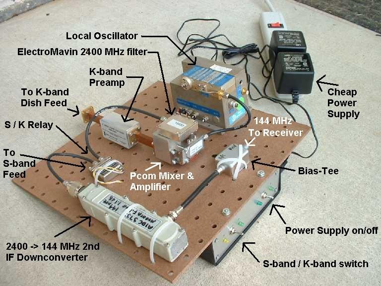

Power Supply
Several voltage levels are required to put this hodge-podge of parts
together in working fashion. At least 16 Vdc was needed for the
MMDS downconverter and the 28 Vdc-rated SMA relay. 12 Vdc
was needed for the P-com mixer and the DB6NT preamp. The
Frequency West brick oscillator utilized –20 Vdc. Finally, to
convert the system to terrestrial work later, I would also need –5
Vdc for the matching P-com upconverter.
I searched and searched for a suitable power supply and found none really suited for this collection of Voltages. Personal computer switching power supplies have most of these Voltages, but require serious surgery to coax the –12 Vdc to the required –20 Vdc. In a hurry to get the system together for further testing, I quickly designed a simple linear circuit using some spare "wall wart" power cubes I recently bought on ebay for $0.99. These units are rated 12 Vdc at 800 mA (unloaded), but tested at over 18 Vdc. Since my initial tests were successfully made with only –16 Vdc, I decided to give it a try. Figure 7: Linear Power Supply Construction: Internals, Front, Rear
The circuit uses a 7812 for the +12 Vdc, a 7905 for the –5 Vdc, and the +18 and –18 Vdc float on the power cube output. The power supply is constructed using simple point-to-point wiring, is contained within a 5x15 cm enclosure with terminals on the back for connecting the various receiver components, and has a pair of 1/8" jacks for connection of +/- 18 Vdc from the outboard power cubes. The two LEDs on the right are used for verifying status of the + and – power busses, and the switch and LEDs on the left are for the S/K relay. After completing the power supply and powering all the components, however, the –18.5 Vdc circuit drooped to –14.5 Vdc as the brick oscillator drew over 350 mA. Testing of the oscillator showed it would operate at the reduced Voltage, but the output of the oscillator was also reduced from the specified 11 dBm to 7 dBm. This was a minor setback, but I searched around the junk box and found a small power supply to substitute for the negative supply cube while I continue the search for power cubes with a little more "oomph." This modular design allows any external sources of +/- 20 Vdc to be used.
Integration and Calibration

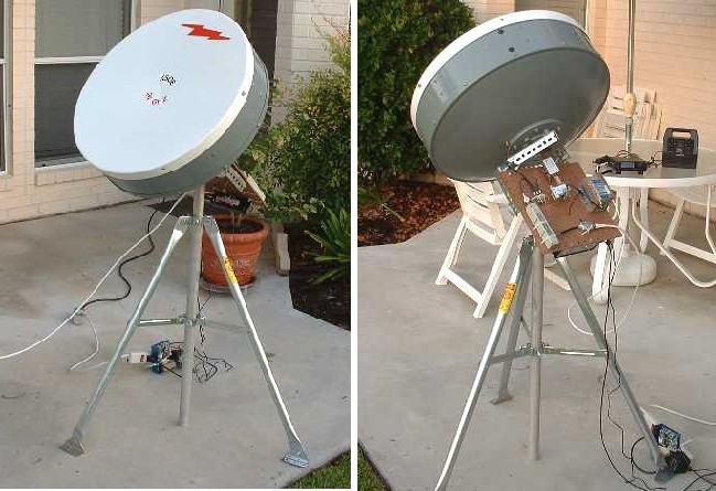

The next step was to integrate all the components in a close-coupled physical arrangement behind
the dish. N1JEZ's crafty setup provided the inspiration for the almost-ready setup shown below
(8). Obviously, the system is set up like a "rover," and not for fixed ground station operation. It is
also a fair-weather design. The common hardware peg board is quite handy for bolting and tie-
wrapping the components in place as well as for routing the power cables through to each device;
ending up with quite a neat arrangement (on top of the board, anyway).

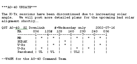

Fate:
I was all ready to go. The very next weekend looked like a perfect opportunity for my first attempt
at hearing the AO-40 K-band beacon: good windows for North America on both Saturday and
Sunday. Then, on 16-July-2002, the unexpected happened…
The curtailment of K-band operation on AO-40 was disappointing, but it also gave me a little more time to work on the system. I made the trek out to K5GNA's shop to put the integrated system on his HP analyzer. We generated a signal at 12 GHz and looked for the harmonic at 24 GHz. We were rewarded with a huge signal visible in the 2nd IF's VHF output, as shown in Figure 9. The overall system measured 54 dB of gain.
I subsequently took the equipment home and set up my own trial using more modest "test" gear. To generate a test signal at 24 GHz, I employed my GM1SXX-designed "duckling" S-band marker oscillator at 2401.500 MHz with the "antenna" generating weak harmonics of the Drake's LO and close-coupled to the waveguide input to the receiver's preamp (9, 10). The "signal detector" used was my FT-100. Finding the signal on the 2nd IF's VHF output was not difficult, but the warm-up drift of the MMDS oscillator was significant once multiplied 10 times! A temperature-stabilized S-band oscillator would make a good tool to have around the shop.

With AO-40's K-band transponder temporarily off, I opted to do a mock test using the complete
system and testing the S/K switching function. The satellite was around MA=220 with a range of
30,000 km and a squint of 15 degrees. It was a simple task to manually point the antenna and find
the S-band downlink. I was unsure what to expect from the unproven loop feed, but was grateful
to see the signal at 5 S-units above the noise on my FT-100 (about equal to what I receive on an
18" DSS dish with patch feed). That proved the S-band half of the setup works to expectations.
To complete the K-band simulation, I then set my mock-AO-40-K-band-signal on top of the patio table—the 2401.500 MHz signal source. The 10th harmonic is at 24,015 MHz. I then rotated the antenna and quickly found the signal with an S9+20 dB reading on my FT-100. I completed the simulation by rotating the antenna in azimuth and confirming I could "lose" the signal. It was a good simulation and I feel I am ready for AO-40 now. I look forward to the K-band downlink's return in the fall/winter of 2002/03.
