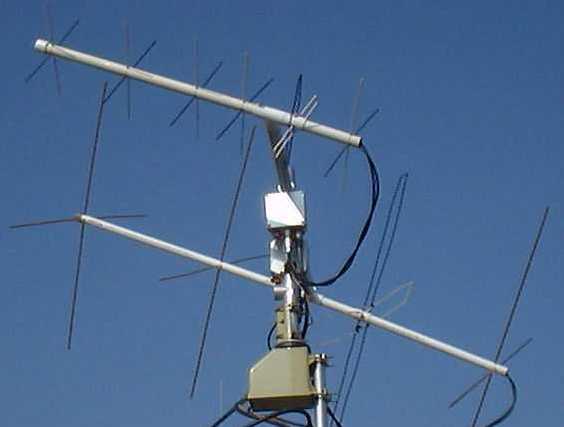

These antennae are elementary and scalable designs. They are practical, easily replicated, and inexpensive to build. Included are a pair of beams for 2 meters and 70 cm and a novel helix design for 13 cm. The builder may choose to employ fixed circular polarity or use switch-able polarity. These antennae are designed with the AMSAT-DL recommendations as a prime guideline and are smaller than the "OSCAR class" described above-much smaller (1). This smaller size leads to less gain. Less gain means wider beamwidth. Wider beamwidth allows less-critical pointing. The inference one may make is automated (and expensive) tracking is not mandatory for P3D. To this end, I offer below designs for 2 meters and 70 cm that will all fit within an imaginary 5' by 5' (1.5 m x 1.5 m) box and can be controlled with TV-type rotors or pointed manually. The final configuration I ended up with is shown above and uses 32" booms for both antennas.

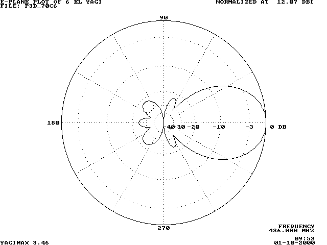

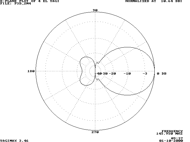

The effort began as a design exercise. The original design criteria for the 70 cm and 2 meter antennas were (in order of importance): 1) circular polarity, 2) gain of at least 10 dBi (per AMSAT-DL), and 3) F/B ratio of at least 20 dB. I started with the intent of using 3 x 3 elements on 2 meters and 4 x 4 on 70 cm. Modeling, however, quickly showed me that I needed 4 elements to reach the 10 dBi goal and still have a dimensionally-tolerant design with acceptable bandwidth. Once committed to a 4 x 4 design on 2 meters, I opted to increase the 70 cm design to 6 x 6 elements since I had the physical space now defined by the 2 meter antenna's boom. Both antennas were systematically developed using K4VX's YagiMax 3.46, verified for behavior in NEC4Win95, and empirically tested using available analog satellites.

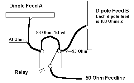

The antennas are designed as linear Yagi-Uda beams, but employing a folded dipole driven element and a phasing line for circular polarity. The physical construction of the folded dipole driven element provides a 4:1 transformation of the nominal dipole feedpoint impedance (2). Thus, the antennae are designed with a 25 Ohm dipole feedpoint, but constructed with a folded dipole element, resulting in a 100 Ohm feedpoint impedance. Then, two of these linear beam antennas are coupled together in parallel fashion via a 93 Ohm (RG-62) coaxial cable, producing a summed feedpoint impedance of (approximately) 50 Ohms. Circular polarity is effected through a 90 degree phase shift inherent in a ¬ wavelength section of coaxial cable. This simple, effective scheme is shown in Figure 1 below and described in detail in The Radio Amateur's Satellite Handbook (3). A builder can choose to avoid the complexity of the relay and simply employ the circular polairty phasing method shown for both the Eggbeater II and the Texas Potato Masher II antennas. The 70 cm antenna produces approximately 12 dBi of gain with a 24 dB F/B ratio and the 2 meter antenna produces a very respectable 10.6 dBi gain with a 23 dB F/B ratio.

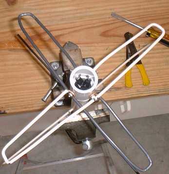

The prototype antenna is constructed using 3/4" (19 mm) PVC piping and # 10 AWG insulated copper wire (0.1" (2.5 mm) diameter of conductor). The driven element is 10-5/8" x 1-1/8" in size. The dimensions are given below in Table 1.

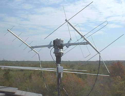

As is visible in Figure 3 above, I did not have elevation control available for testing the antenna, but I did manage to work quite a few low-elevation passes of various LEO's with moderate success (with the antenna set at about 15 degrees elevation). I made it into SO-35's very(!) competitive transponder at the northern LOS with this antenna, whereas I could never accomplish that feat with my "everyday" TPM II (4). I was also able to work AO-10 with ease out to 30,000 km using 100 Watts: working both New Zealand and Europe from Texas with 55+ signals on SSB (between the fades, of course).

Figure 5: 2 m Beam Free Space Azimuth Plot
AO-10 performance, the real test for a 2 meter satellite antenna, was outstanding, as the ability to switch circular polarity made this the better performer when directly compared to my 7-element horizontally-polarized antenna (5). On uplink, I could reach beacon strength on CW into RS-13 with 5 Watts. I really hated to take this antenna down.

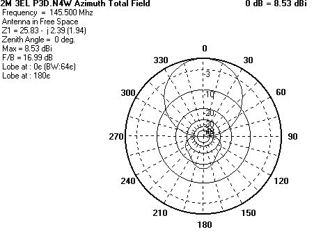

This antenna is the one I ultimately constructed for use on P3D using 3/4" (19 mm) PVC piping and elements fabricated from 1/4" (6.35 mm) aluminum tubing. This antenna models at a gain of 8.5 dBi and a F/B ratio of 17 dB--not nearly as good as the 4 element version, but the boomlength is only 32" (81 cm), the same as the 6x6 UHF beam. This combination provided me with a very low profile system--necessary in my deed-restricted neighborhood . See the picture at the top of the page for the installed antennae. The driven element is, again, formed using #10 AWG insulated wire and is 34-1/4" x 4" in size. The nominal dimensions are given below in Table 4.

Driven Elem.39.000 / 99.0 (x 2)17.0 / 43.2
Director 136.250 / 92.132.0 / 81.3
